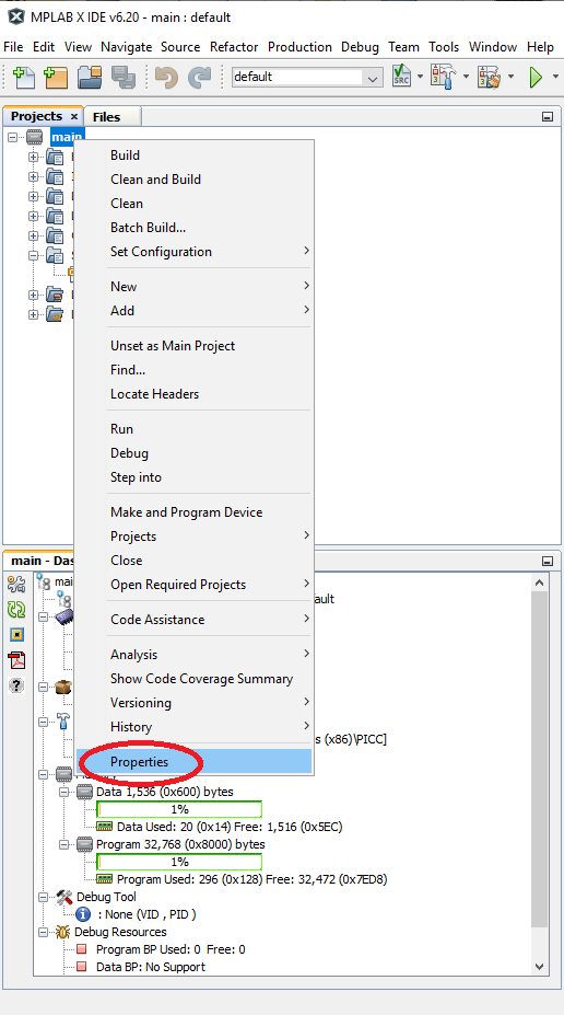

  1. Right-click the project name in the Projects box and select Properties.
    Open project properties way 1

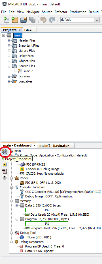

  2. Left-click the wrench icon on the project's Dashboard.
    Open project properties way 2

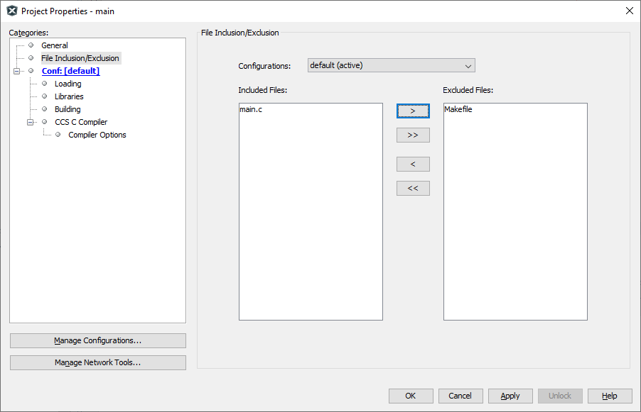

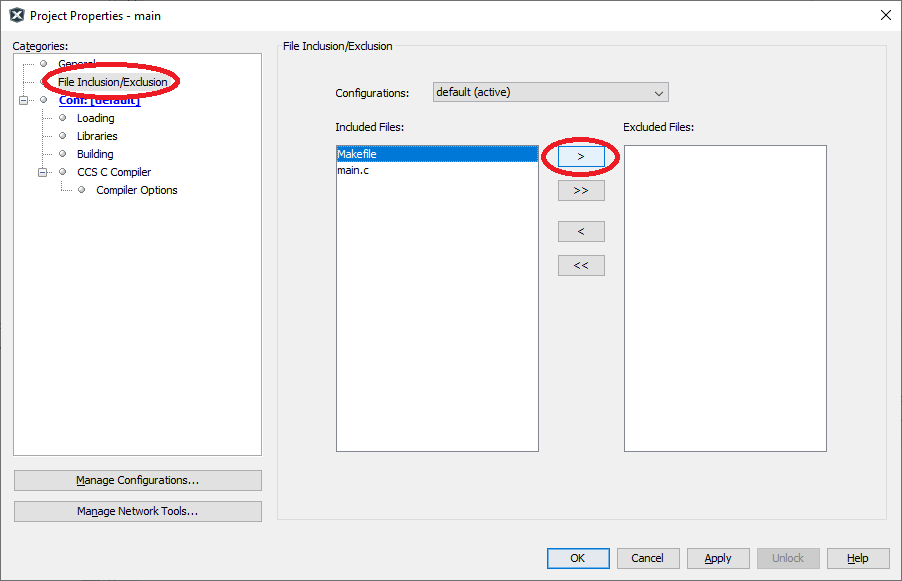

In the Project Properties box that opens, select File Include/Exclusion on the left-hand side. Then under Included Files: select Makefile and click the '>' button to move it over the Excluded Files side.
Change project properties
Save project properties
Finally click the Apply button followed by the OK button at the bottom of the Project Properties box to save the changes. After make the above changes the project should build correctly, assuming no errors in the project's code.
