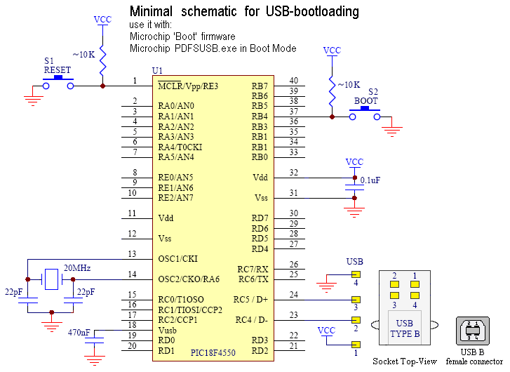

Hello Everyone,
I´m trying to put to work the example of CCS “ex_usb_bootloader.c” with 18F4550, “siow.exe” and “teraterm.exe". I have spent three days under this and I don’t know how to put things to work, as mentioned for others members.
It seems to be related to the memory map, but I don’t have any idea about what I have to change.
I will describe everything I did, and post entire code. If anybody could give me some directions, it would be great and I would be thankful.
1 – Everything looks ok, just the application don’t run after send from siow.exe or teraterm.exe.
2 – Using PCWHD version 4.134. Mplab version 8.91. Siow version 4. Teraterm version 4.73. The schematic that I used was:
[img]
http://www.hobbielektronika.hu/forum/getfile.php?id=3688
[/img] (alt+p)
3 – I’ve follow the ex_usb_bootloader.c. I didn’t change anything on this code. I've only changed the code “ex_usb_common.h” for change the pins of Leds and comment the usb sense and ADC stuffs. This part is called at the beginning of “ex_usb_bootloader.c”.

4 – I Compiled the code with Mplab and everything was ok. No errors. I’ve used the Pickit3 to load the bootloader on PIC and ok.
5 – My application is very simple, just blink a Led.

Joined: 11 Mar 2010
Posts: 20066
PostPosted: Fri Jan 29, 2016 5:19 am     Reply with quote
The USB bootloader will work fine on your chip.
Study it. It does not use interrupts.
You are trying to bodge the interrupt handler to route interrupts to two different targets. This can be done, but 'why bother' It is much safer (and a little quicker) to use the USB as the example bootloader does with the interrupt polled.
You then have the interrupts set up to be used by the USB (which will therefore assume these are used), but you never enable the global interrupt (study the examples, _you_ have to do this if you are using the USB interrupt driven). So your code won't work...
SubhamayS
Joined: 07 Mar 2012
Posts: 34
Location: jalpaiguri, India
PostPosted: Mon Feb 01, 2016 12:22 am     Reply with quote
I have tried using the CCS example bootloader, (without interrupts) but still the problem prevails. Windows is saying CSC BOOTLOADER not found. Contact manufacturer support section of your device for the driver. I have also tried searching the driver online but no driver is available. selecting the .inf file is also not working. The CDC diver is not present in the windows drivers list. I am using Lenovo Thinkpad T420, Windows 7 Professional 64-bit. Please Help ! :(
Joined: 11 Mar 2010
Posts: 20066
PostPosted: Mon Feb 01, 2016 2:40 am     Reply with quote
The driver is in your PIC directory.
In the drivers sub-directory. "NT,2000,XP,VISTA,7,8,10", then the file "cdc_NTXPVista_7_8_10.inf"
SubhamayS
Joined: 07 Mar 2012
Posts: 34
PostPosted: Mon Feb 01, 2016 9:06 am     Reply with quote
Did it as you have suggested. But the problem prevails. Another fact is that, the USB serial communication is working fine on my board with 18F2550. The driver is also recognized easily. I was looking at the cdc_NTXPVista_7_8_10.inf file.
;%CCS_CDC%=Reader, USB\VID_0461&PID_0033        this was removed for WHQL certification since it's not CCS's VID
;%CCS_CDCBOOT%=Reader, USB\VID_0461&PID_0034    this was removed for WHQL certification since it's not CCS's VID
The above lines are commented. Is that an issue !!!! Rolling Eyes
Joined: 11 Mar 2010
Posts: 20066
PostPosted: Mon Feb 01, 2016 9:34 am     Reply with quote
No. The VID should be 2405, and the PID should be 000c for the bootloader if you are compiling the example with the current settings. This is half a dozen lines further down in the file as CCS_CDCBOOT2.
If the device has VID 0461 listed, then you are using an old file in the compile. This is MicroChip's VID that was used at one time when the CCS code was a translation of the MicroChip code, and hence had to be removed.
Goto page 1, 2  Next
