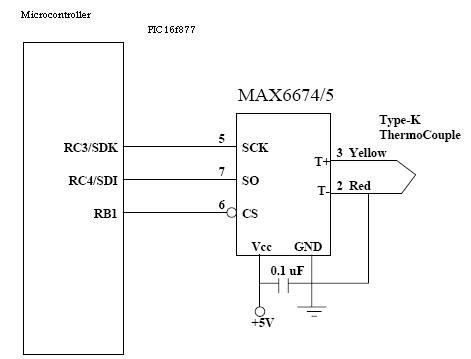

I took MAX6675 codes from this thread http://ccsinfo.com/forum/viewtopic.php?t=21676&highlight=max6675 and added just a simple lcd printout.
Connection is like this:http://2.bp.blogspot.com/_CvxN91KM3Rc/TASwrd-qn3I/AAAAAAAAApI/27K1IPY9pss/s1600/Microcontroller+PIC+thermocoupler+interface.JPG except CS, it is now A1.
Circuit uses internal 4MHz oscillator. I tried also with external 20MHz crystal.
Problem is: 6675 returns 0 (zero).
I can't figure out what the problem is, any ideas?

1. What is the Vdd voltage of the PIC, and the Max6675 ? Are they
running at different Vdd voltages ?
2. Post a list of the connections between the PIC and the Max6675.

PIC-------------------MAX6675
RA1(3)--------------- /CS (6)
RC3/SCK(14)-------SCK (5)
RC4/SDI(15)--------SO(7)
Both are running the same Vdd: 5.01V.
Thermocouple negative is connected to MAX6675s GND and there are filter capacitors in power pins as specified in datasheets.
