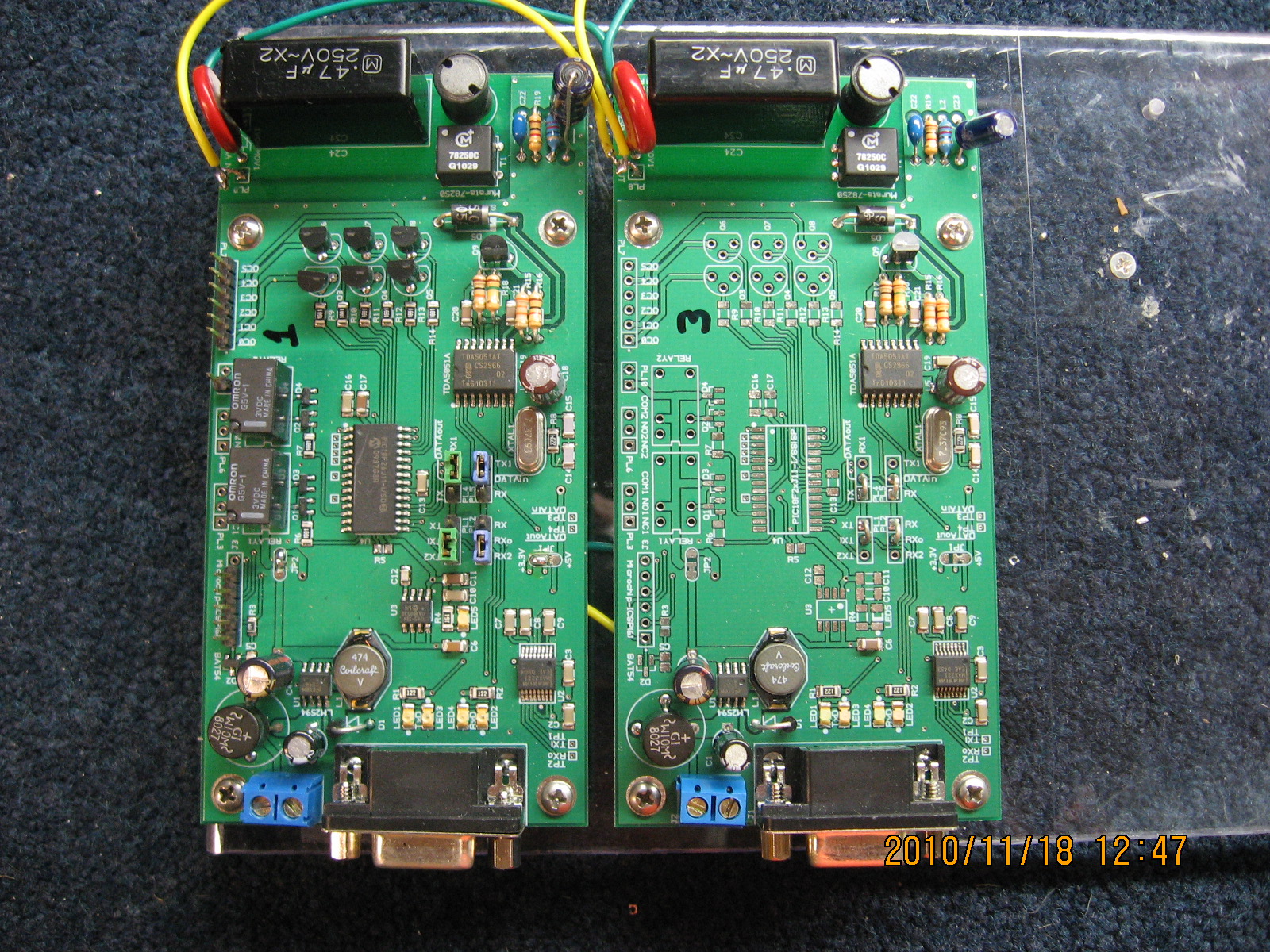

I did something like that last year (maybe the one before that) using that very module.
Once you have the hardware, the PIC's just use 1200bps from the UARTs (like RS232 - but not) and you also have to detect collisions.
That's why CCS doesn't have "sample code" -- because there isn't any needed. It's #USE RS232 all the way...

PostPosted: Sun Feb 05, 2012 3:13 pm     Reply with quote
whoa. I forgot how big that pic is.

Posts: 9522
PostPosted: Sun Feb 05, 2012 3:46 pm     Reply with quote
It's just the right size for an old guy like me to be able to SEE the components to solder...!!

PostPosted: Sun Feb 05, 2012 4:25 pm     Reply with quote
hahaha...
That's what magnifiers (or micro-scope cam's) are for!
