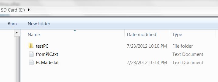

In the uC I can print out the address that my pic18f thinks is the root directory (1064960). This address, to my untrained eye appears correct based on the image below. Does it appear correct to you. There are other files that I added to root to test to see if uC would see them (second image - these don't show up in root directory of hex editor and they are not visible from uC). I purposefully kept file names under 8 characters but doesn't make a difference (I have tried long filenames as well).
Explorer
Same symptoms: I can create the file, then open it and append data to it, BUT ONLY if it is done sequentially.
For instance:

The uC, though cannot see, read, append to or enumerate files or folders that already exist on the SD card. Even if the uC created the file in the first place. If I run the above code and then run the following code:
Code: |
AppendFile(filename,"the test worked - written to by PIC");
AppendFile(filename,"Second append - written to by PIC");
PrintFile(filename,0);
disp_folder_contents(g_CWD);
I get an error saying that the: "Error opening file" and there are no files or folders printed out via disp folder contents.
Any ideas anyone??? Seems very strange to me. As if the act of creating a file initializes something somewhere so that the uC can open the freshly created file. Though I have tried to create a dummy file, and open an existing file and that does not work. So I am at a loss.
